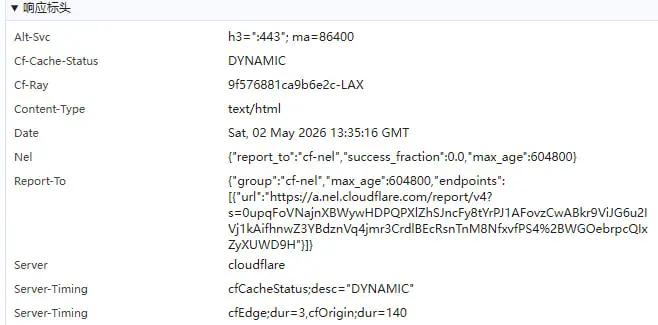

对于tcp,cdn会导致流量放大数倍,因为添加了极大多数的无用标头,原始只会返回这点东西,header内容如图所示
通过cdn流量放大了十几倍,udp返回的东西更少,更加省流量,所以udp你连下载完成数都看不到,就是为了节省
包括cdn要把标头发给服务器,服务器上就平白无故多出来10M下行流量的差距,下行上行不对等了,总之问题不大

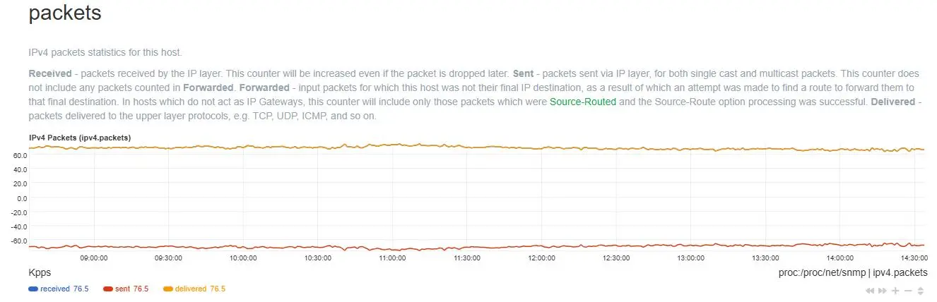

The opentrackr number you report from victorarle I find hard to believe is a true number to be honest.  I should be receiving the same level of traffic and actually more because the tracker is on another more chinese based list as well.
HTTP-METRICS dt=60.0s req=50 (0.8/s) get=50 post=0 2xx=50 3xx=0 4xx=0 5xx=0 err=0 announce=40 scrape=4 manage=0 live=6 splash=0 webhook=0 other=0 http=0 https=50 slow250=12 slow1000=0 avg_ms=154.8
UDP-METRICS dt=60.0s rx=40371 (672.8/s) enq=37470 deq=37547 done=37547 drop_adm=2901 drop_q=0 connect=9284 announce=19101 scrape=395 invalid_cid=8767 unknown_action=0 banned_err=15 pkt_err=0 send_ok=37547 send_err=0 send_kib_s=22.2 q=317/512 inflight=325/512 workers=8 conn_ids=23043
RUNTIME-METRICS dt=60.0s active_torrents=372922 live_peers=560388 registry_torrent_keys=401949 registry_downloaded_keys=217990 registry_downloaded_touched=217990 registry_hash_locks=417890 registry_persisted_rows=0 ban_cache=1038 wild_enq_q=4096/4096
Over 60 secs only 672 packets per second were being processed.  75k connections per second would be an absolute insane amount to the realm of about 150,000 packets/sec minimum.
I actively ban abuse traffic like a crazy person as well.  I think the numbers would be through the roof if I didn't do banning.  I don't know what opentrackr abuse handling is.

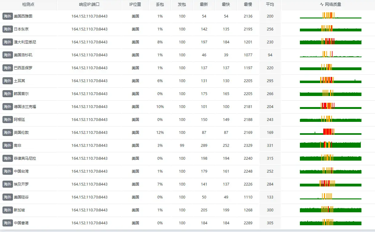

你的数值当前是65536比较小,建议修改成一个较大的值1048576,通过ping测试,你的系统已经触发了限制引起大约10%网络丢包
https://www.itdog.cn/tcping/tracker.wildkat.net:8443
还有个丢包的可能性是文中提到的防火墙,跟踪表溢出引起的丢包,建议禁用iptables来关闭nf驱动模块

No such file or directory就是最理想的状态了,代表防火墙已经成功禁用,此时不会触发nf驱动引发的丢包
你这个丢包不是灾难性持续性的,而是偶发,应该是瞬时流量引发的,你应该在代码加入可靠的差分技术
opentracker可以对每次请求随机6分钟差分,例如2小时一次就是 1:57:00~2:03:00 正负值各为3分钟,随机下发一个值返回给用户
所以此时就会很平滑,没有在出现cpu峰值情况
差分后的例子,24小时数据包是平滑的,没有任何峰值凸起,稳定在80K连接数每秒并发左右
你的服务器现在是固定30分钟请求一次,那么会发生瞬间峰值现象触发了你的ulimit 65535上限值,从而导致丢包

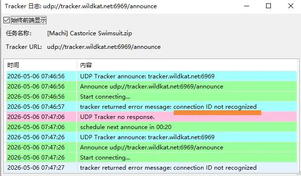

给你提到的问题发生在任何一款客户端上
世界上全部的种子客户端使用你的udp tracker都有问题,你要做的是根据我的说法去兼容现有的客户端,参考附件
https://web.archive.org/web/20260506004744/https://send.itzmx.com/files/K5xUweMjMuHm0ukD1SgACjE.gif
Strange, never have such issue &#128578;. Ill review, seems that is utorrent.
I do fast test with qbittorrent, it work well.
I dont understand your issue &#128577;
I cannot replicate your issue with utorrent nor qbittorrent.  I assume this is great wall of china blocking you.  I dont know otherwise.
Advise switch to qbittorrent https://www.qbittorrent.org/ utorrent is like malware &#128533;
你可以在你的服务器上抓包搜索,可以看到每秒大量的Connection错误数据包发出
tcpdump -ni eth0 udp port 6969 -A | grep -Ei "Connection"
刚测试了qbittorrent v5.1.4,确实没有这个现象,因为qb在发udp的时候始终先请求全新的transaction ID用于获取Connection
除了qbittorrent以外的其他客户端都有这个问题,除非你的tracker不提供给他们与服务器进行连接,否则应该做兼容处理

比特彗星有一样的Connection错误问题,但是这和你提到所谓的中国网络无任何关系,这是tracker服务器代码设计缺陷
附件为加拿大的种子服务器上复现截图(需要在debug模式下显示日志,可用wireshark确认),如果无法打开这个大文件附件,请访问此链接
https://web.archive.org/web/20260506153635/https://send.itzmx.com/files/DHLbXxF1NC0K7FFT6kVI1qw.gif
I am working on it.  After 2 minutes I expire that connection id per protocol.  Bitcomet never requests again even though it gets the error telling it why!  I make UDP tool and monitoring behavior of that client.
Below is bitcomet stopping and starting torrent until server ages out the CID and bitcomet then does not request a new.  At CID age 171 is rejected and never requests again.

Bep34 aware clients will automatically be redirected to udp.  Though I don't know if any clients actually support this feature.
据我所知只有utorrent支持bep34,那么这个问题就结束了喵!你的udp tracker现在正常工作,之前无法二次进行announce实在太过于bug了,不应该追求bep(bep本身也有设计缺陷),而是考虑现实网络的客户端运行环境才是最重要的
如果你要感谢我,可以在公共场合发表评论 例如ngosang issues,或者我的仓库,可以在互联网上留下一个脚印帮助其他开发者或者提供tracker服务器的管理员去调优

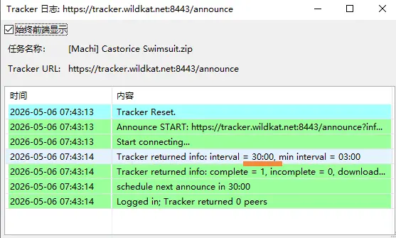

提到的一项优化改对了,不过你还需要在改进一下,现在如果同时添加udp和tcp两种协议进行announce,两者的返回时间是一样的
应该每次进行announce的时候返回随机值,你现在这是同一个用户相同的种子每次announce固定在了一个时间,应该彻底对每次请求进行随机
要考虑同时运行两种协议的情况
That torrent is randomized to that value based on hash and peer id, it will stay like that until a new peer id is created.  Add a new torrent and that specific torrent will a new value.  I did not implement "random" for each request.  It is random based on hash + peer id.  Unless those values change then that is the value for that specific torrent for you.
I think its ok.  It achieves the goal that person with massive amount of torrents will have unique values for each.  Your trackers you have listed should be tiered anyhow.  Place those both on the same tier so you are not needless query same source.
